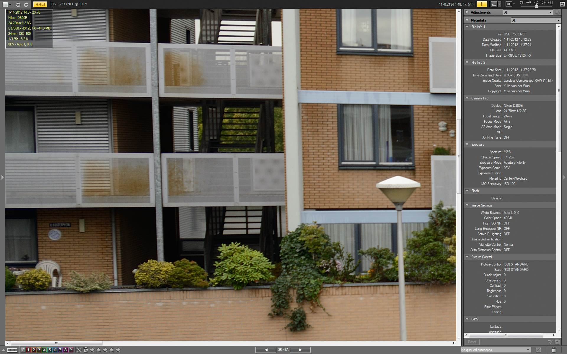

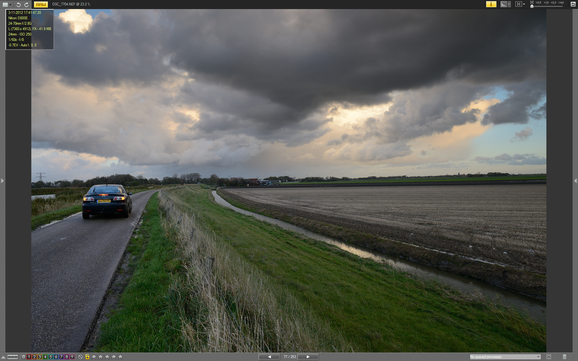

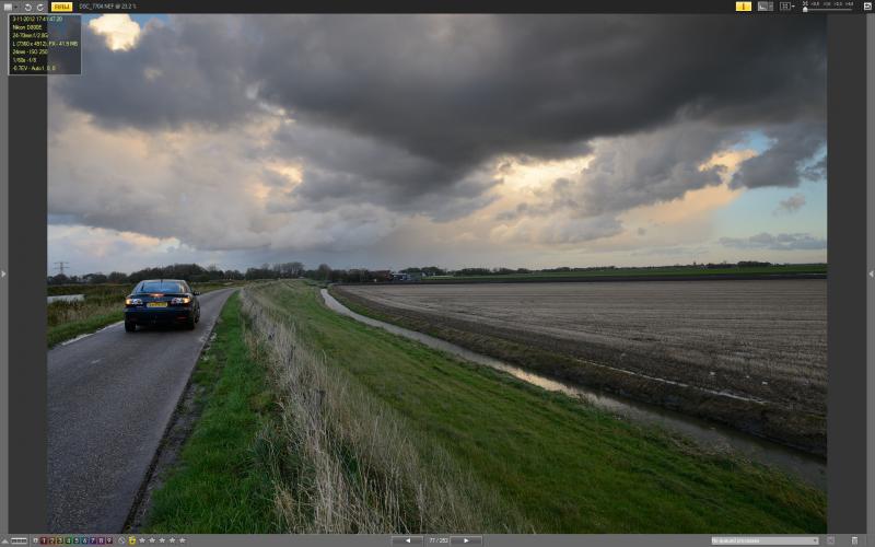

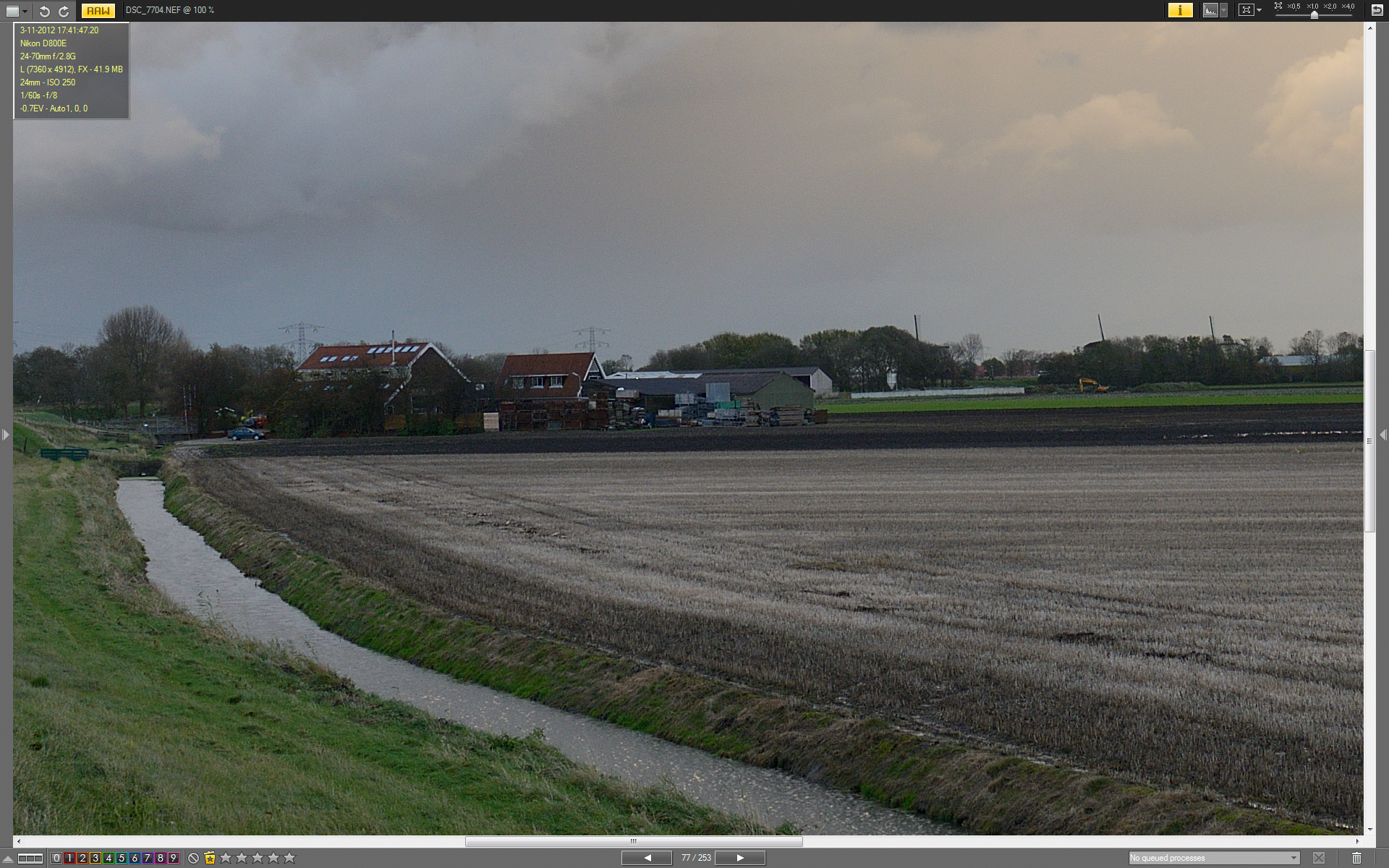

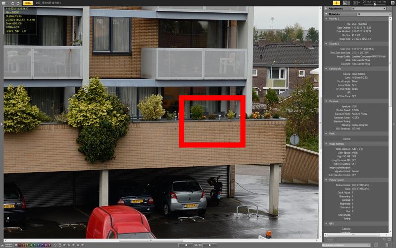

My Nikkor 24-70/2.8 has a long own history:
1. A couple months after I had bought it, it had got a well-known problem of zoom-ring. Our local Nikon service sent the lens to Dusseldorf for reparation (see reparatienummer 53660, 16-10-2009).
2. From the very beginning the right side of the picture was visually softer than the left one. At that time I used the lens on my D200, but after buying D700 the issue became more obvious on FX-pictures, that is why I had to bring the lens to NSP for a necessary correction (see reparatienummer 61521, 14-05-10). The lens was adjusted, but on testing it I noticed the lens had lost its sharpness completely.
3. That is why I had to bring the lens to NSP again to correct the issue, this time together with the body (D700), (see reparatienummer 62148, 28-05-10). The camera was investigated and adjusted. The lens was aligned. The sharpness had improved a little bit, but never became the same as it was before the reparation. Also after the interference the lens became not symmetrical – now the left side of the picture looked much softer than the right one. It looked like the left side got a front-focus, and the right one had a back-focus. Also the lens became not so sharp at its 70 mm and around.
4. I asked for a correction of the problems, but no deviations were found (see reparatienummer 69086, 22-10-10 and reparatienummer 94330, 28-03-12). Every time the lens was again adjusted. But it has not helped.
Now the lens has the following problems that are revealed on all my Nikon bodies – D800E, D7000, D700 and on some older bodies that I do not use much anymore (D90, D200, D300, Fuji S5 Pro):
1. The left side looks softer than the right one. It is notable at any focal length, but more prominent at 24 mm when only the center is sharp, both sides are always soft at any diaphragm, closing diaphragm up to 8 and further does not help much (for landscapes). The left side of a photograph seems to have a front-focus and the right side has a back-focus, I can see it when I compare a forefront and a background of the picture.
2. When I try to make a picture at 70 mm and use utmost focusing points, I cannot get a sharp photograph, even if I close the diaphragm up to 5.6 and further.
3. When I test the lens with Spyder LensCal at 70 mm, I can see a strange image: All vertical contrast contours have something like “a diagonal shadow”, and the horizontal ones – not. It happens even in the center of the picture. The effect disappears only by the diaphragm 8. The same strange (double) structure is available at corners (and in the parts that contain bokeh) of any picture at any diaphragm and at any focus length (to a greater or lesser extent).
4. The effect of the soft sides sometimes becomes worse when I stop down the diaphragm.
5. The lens shows a prominent front focus on all my bodies (the bodies were investigated and adjusted at NSP). The front-focus is more prominent at the wide-end of the lens.
6. After the last reparation at NSP I noticed a little hair behind the rear lens.
I am mostly a landscape photographer; that is why the sharpness all over the picture is so important for me. But also I would like to use the lens for reportage with an open diaphragm; however so far I cannot trust the lens.
I hope I have made the problem clear and you can solve it.
Regards,
Yulia van der Waa

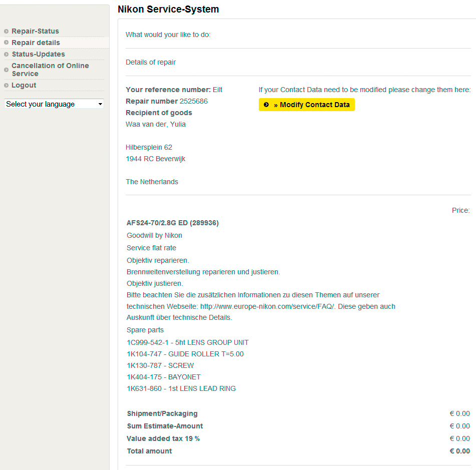

Из предварительной переписки с немцами стали ясны правила ремонта: я отправляю стекло в Германию за свой счет, они производят его диагностику (стоит это что-то около 40 евро), они высылают мне заключение и счет за необходимый ремонт, диагностику и стоимость отправки назад (35 евро курьерской почтой Германии). Если я соглашаюсь, то его ремонтируют. Если нет, то отправляют мне назад после того, как я оплачу стоимость диагностики и стоимость пересылки.
Сижу, жду. Вдруг в пятницу приходит сообщение, из которого следует, что ремонт завершен. Я пишу им и спрашиваю, почему они взялись за ремонт, не поставив меня в известность о его стоимости.
Сегодня утром получаю объяснение:
Good morning Ms. Van der Waa,
I´ve talking back with the technician and we have checked the repair documents. In this case we have decided, that the lens repair is without costs for you.
We send back the lens today or latest tomorrow.
Kind regards
Anja Kretke, Customer Support
То есть, из этого следовало, что просмотрев все квитанции по ремонту моего многострадального стекла, они пришли к выводу, что ремонт должен быть произведен бесплатно, к тому же даже не взяли денег за пересылку.
И вот детали ремонта:
Они бесплатно заменили пятую группу линз, байонет, кольцо первой линзы (?), винт, всё отъюстировали... и это при том, что голландский СЦ утверждал, что всё укладывается в пределы нормы. И после двух с лишним лет по истечении гарантийного срока rolleyes
Вообще-то я не очень представляю, что конкретно означают замененные детали:
1C999-542-1 - 5ht LENS GROUP UNIT
1K104-747 - GUIDE ROLLER T=5.00
1K130-787 - SCREW
1K404-175 - BAYONET
1K631-860 - 1st LENS LEAD RING
Но очень надеюсь, что теперь это должно помочь.
С нетерпением жду, когда объектив окажется в моих руках, чтобы его попробовать.
Обязательно отправлю в Дюссельдорф и другие "упрямые" фотоигрушки smile
Re: Блог владельцев Nikkor 24-70 f/2.8
Интересно, где здесь 5ht LENS GROUP UNIT, и какую функцию эта группа выполняет? Зачем нужно было ее заменять?
Всего в объективе 15 линз в одиннадцати группах: 15 elements in 11 groups (with 3 ED glass elements, 3 aspherical lenses and one Nano Crystal Coat)
MadFox
Сообщения: 9610
Сообщение MadFox »
Посмотрел:
1C999-542-1 - 5ht LENS GROUP UNIT - последние линзы, которые уже смотрят на матрицу
1K104-747 - GUIDE ROLLER T=5.00 - пластиковая фиговина, по которой ездит 1st LENS LEAD RING
1K130-787 - SCREW - винт который держит пластиковую фиговину
1K404-175 - BAYONET - байонет
1K631-860 - 1st LENS LEAD RING - собственно кольцо зума, которое вылезает спереди, которое ездит по "пластиковая фиговина, по которой ездит направляющая зума"
Via Est Vita
MadFox писал(а): Пн окт 29, 2012 20:48
Посмотрел:
Большое спасибо! drinks
А имеете какое-нибудь представление, что дает замена байонета и последней линзы?
Про механизм зуммирования догадываюсь, всё-таки это механика, а объектив эксплуатировался ежедневно, в разных условиях.
MadFox
Сообщения: 9610
Сообщение MadFox »
Кольца с фиговинами - При зуммировании эта фиговина может срабатываться, и соответственно менять положение линзы, люфтить.
5 группа линз - там группа линз в оправе и с креплением винтами по бокам. Я так понимаю если линзы перекосятся внутри оправы - это уже меняется а не чинится/юстируется.
Байонет - к нему крепится 5 группа линз. Соответственно если предположить что, например крепежные отверстия разбиты (обьектив не самый легкий) или что-то в этом духе - то лучше заменить, тем более что на байонете висит вся перпендикулярность матрице всего объектива
Все выше сказанное - чистейшее ИМХО.
ЗЫ: немецкий язык это нечто, язык и мозг сломал, набирая на клавиатуре буквы, которых на клавиатуре нет.
Via Est Vita
MadFox писал(а): Пн окт 29, 2012 20:58
Спасибо!
Очень надеюсь, что теперь всё будет лучше. Всё-таки немцы молодцы. Я даже не ожидала от них такого понимания и щедрости и просто человеческого отношения.

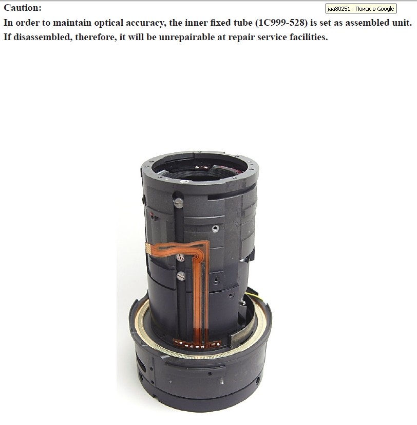

Вот также важный модуль для симметричности линз. Ремонту не подлежит. Если, не дай бог, проблемма в нём, то можно долго натраивать.

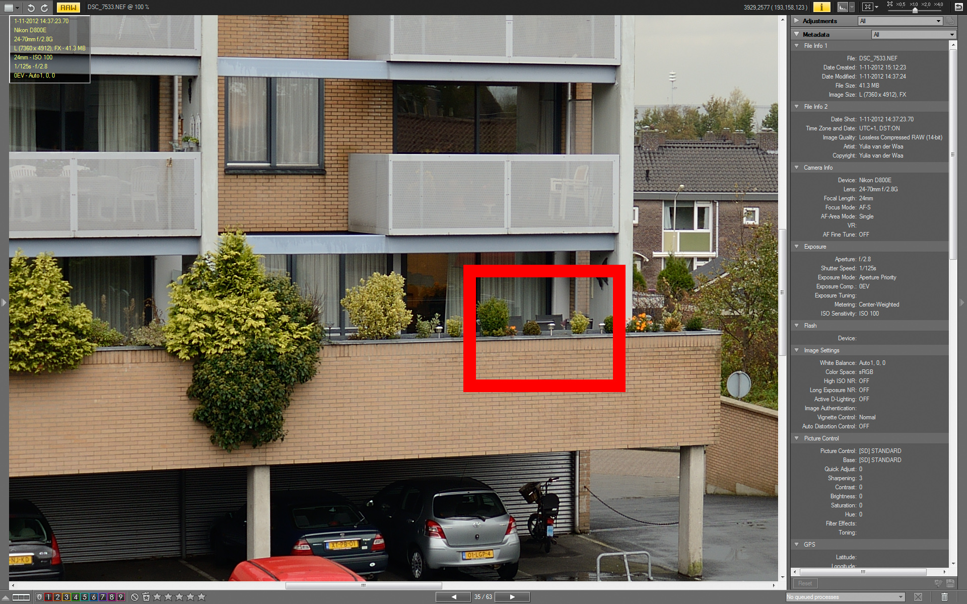

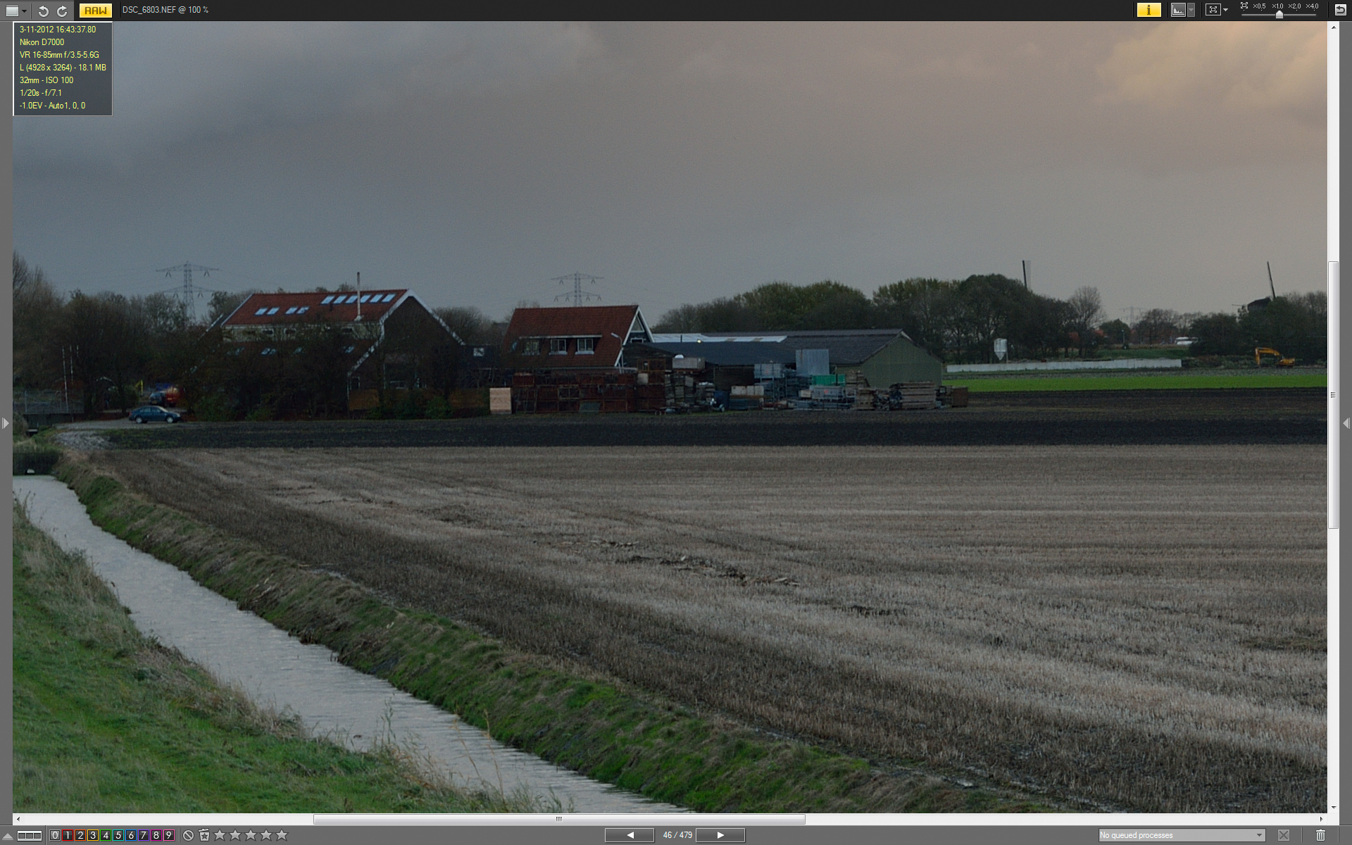

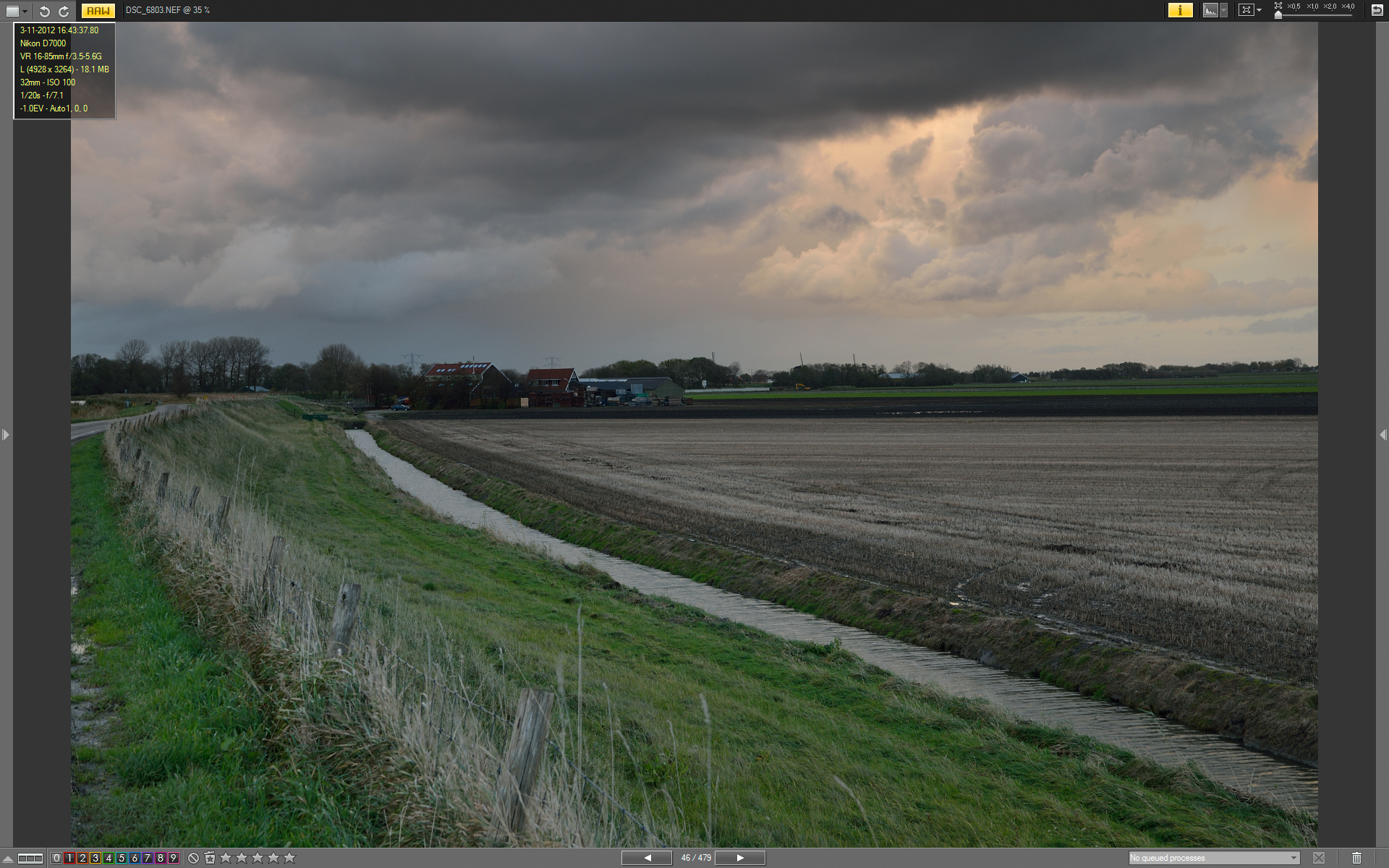

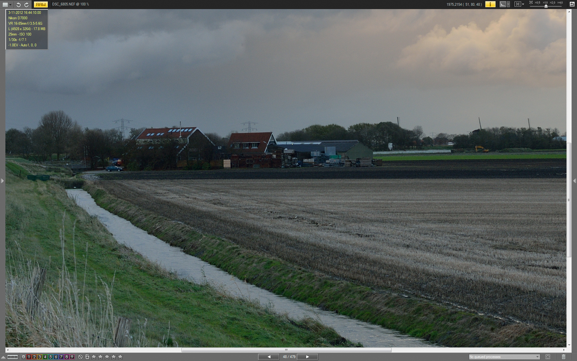

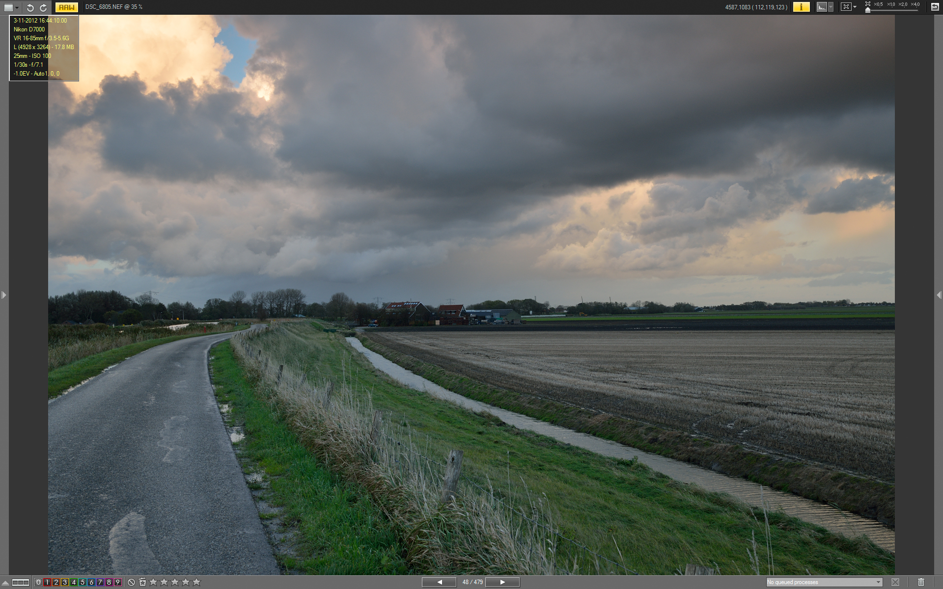

Проверять объектив пришлось уже при очень тусклом электрическом свете и со вспышкой. Единственное, что приходило в голову, когда я видела эти результаты... "Я плакаль!" biggrin Мне вернули совершенно другой объектив. Он стал резким от края до края на открытой на любом фокусном на Д800Е (насколько это вообще возможно и по сравнению с прошлым). Попадал точно при фокусировке каждой из 51 точек (на 70 мм на 2.8).
Чтобы сравнивать, нужно повторить то же самое, что было раньше. Старых тестов почти не сохранилось. Так что это достаточно проблематично. Проще завтра поехать на природу и поснимать что-нибудь из привычных сюжетов.

Julysha писал(а): Вт окт 30, 2012 23:40
Хорошая новость!
Ну если и от фронт-фокуса на 24мм избавили и фокальное поле выпрямили, то осылаю тоже. smile
Зум кольцо работает плавно?
sergejv писал(а): Ср окт 31, 2012 14:57
Хорошая новость!
Ну если и от фронт-фокуса на 24мм избавили и фокальное поле выпрямили, то отсылаю тоже. smile
Фокальное поле не исправили (кривизна фокального поля - особенность репортажных зумов), а зум у него никогда не заедал и до этого ( с тех пор, как его четыре года назад исправили в том же Дюссельдорфе), так что совсем не понимаю, зачем его заменяли.
Фронт-фокуса на 24 мм на моем 24-70 уже давно не было. Если и требовалась поправка АФ при переходе с камеры на камеру, то на всех фокусных одинаковая. Сейчас остается только приспособиться к новым реалиям и новым поправкам АФ в камере, которые помогают бороться с кривизной поля на пейзажных сюжетах. Каждая новая юстировка - это, как новый объектив, на разных камерах ведет себя по-разному.
Здесь еще вот какое дело: на 24-70 (так же, как и на 14-24) имеется шифт-фокус, это когда при зажимании диафрагмы фокус смещается назад. На Ешке это очень хорошо видно. Так что фабричная настройка объектива сделана с учетом этой особенности стекла (на 24 мм чаще снимают на зажатой, а на 70 мм снимают в основном на открытой).

В общем, 16-85 (общий вид и 100% кроп):
Ешка + 24-70:
ЗЫ Нашла еще одну картинку с 16-85, даже на 25 мм, так что полный паритет с 24-70:
